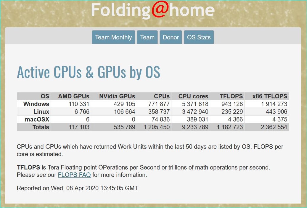

Je cite toTOW sur le 'tchat de l'AF :
  Citation
L'exaflops natif est dépassé. Et les 2 exaflos en équivalent x86 : https://stats.foldingathome.org/os
Développer
edit : Jason d'EOC ce jour : News & Updates
  Citation
Everyone deserves a pat on the back!04.08.20, 11:57am CDT
Literally in the span of a week, according to the FAH Client Stats you guys have DOUBLED the processing power and now have exceeded 2.3 (x86)exaFLOPs!
The new totals (compared to those I posted LESS than a week ago): 117,103 AMD GPUs (47.30%up.v1.gif) / 535,769 Nvidia GPUs (50.47%up.v1.gif) / 1,205,450 CPUs (102.94%up.v1.gif)
A couple cool videos on YouTube, first is from the Financial Times interviewing Dr. Bowman and a little talk about the Folding@Home project and the science behind it. Second video is from Linus Tech Tips where Linus shows off the Folding@Home WS Server they built and is currently part of the F@H Server Pool, helping to send out all those work units to all you guys keeping those GPUs & CPUs busy!
As for recent team production, it looks like Linus Tech Tips Team is currently in the lead, with the Default Team trying to keep pace, but the big surprise is AWSFolds sneaking up from the back of the pack and putting on the heat against the other top teams! If AWSFolds continues to ramp up like they have been we might have a new top contender! There were a couple times late 2017 / early 2018 where CureCoin broke 60 BILLION points produced in a month... It looks like that record *could* get shattered this April by any (or all) of these top 3 teams if they can keep up the pace!
Développer
