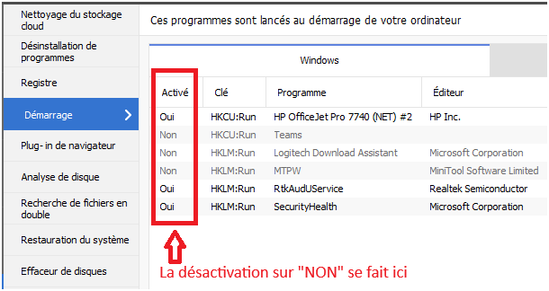

2. Programme lancés automatiquement au démarrage :
arrow210.gif  La liste manque

1. Liste des applications à placer sur "NON" dans CCleaner pour désactiver leur lancement automatique au démarrage :
  • Adobe Acrobat Synchronizer		"C:\Program Files\Adobe\Acrobat DC\Acrobat\AdobeCollabSync.exe"
    CCleaner Smart Cleaning		"C:\Users\aber9\Downloads\ccsetup640(3)\CCleaner64.exe" /MONITOR
    EPLTarget\P0000000000000002	Seiko Epson Corporation	C:\WINDOWS\system32\spool\DRIVERS\x64\3\E_YATIXXE.EXE /EPT "EPLTarget\P0000000000000002" /M "WF-2820 Series"
    EPSDNMON	Seiko Epson Corporation	"C:\Program Files (x86)\EPSON Software\Download Navigator\EPSDNMON.EXE"
    DataCollectionAgentController	Seiko Epson Corporation	C:\Program Files\EPSON\Epson Data Collection Agent\DataCollectionAgentController.exe
    EEventManager	Seiko Epson Corporation	"C:\Program Files (x86)\Epson Software\Event Manager\EEventManager.exe"
    EPPCCMON	Seiko Epson Corporation	"C:\Program Files (x86)\EPSON Software\Epson Printer Connection Checker\EPPCCMON.EXE"
    FUFAXRCV	SEIKO EPSON CORPORATION	"C:\Program Files (x86)\Epson Software\FAX Utility\FUFAXRCV.exe"
    FUFAXSTM	SEIKO EPSON CORPORATION	"C:\Program Files (x86)\Epson Software\FAX Utility\FUFAXSTM.exe"
    HP Software Update	Hewlett-Packard	C:\Program Files (x86)\Hp\HP Software Update\HPWuSchd2.exe
    HPMessageService	HP Inc.	C:\Program Files (x86)\HP\HP System Event\HPMSGSVC.exe
    IAStorIcon	Intel Corporation	"c:\program files\intel\intel(r) rapid storage technology\iastoriconlaunch.exe" "c:\program files\intel\intel(r) rapid storage technology\iastoricon.exe" 60
    iTunesHelper	Apple Inc.	"C:\Program Files\iTunes\iTunesHelper.exe"
    Démarrage du CCM.lnk	ASIP SANTE	C:\Program Files\santesocial\CPS\CCM.exe
    Shortcut to AA.lnk	SNAL	C:\Program Files (x86)\SNAL\SnalServer\SnalServer.exe
2. Redémarre ton PC et communique-moi la taille actuelle de l'espace libre, stp
